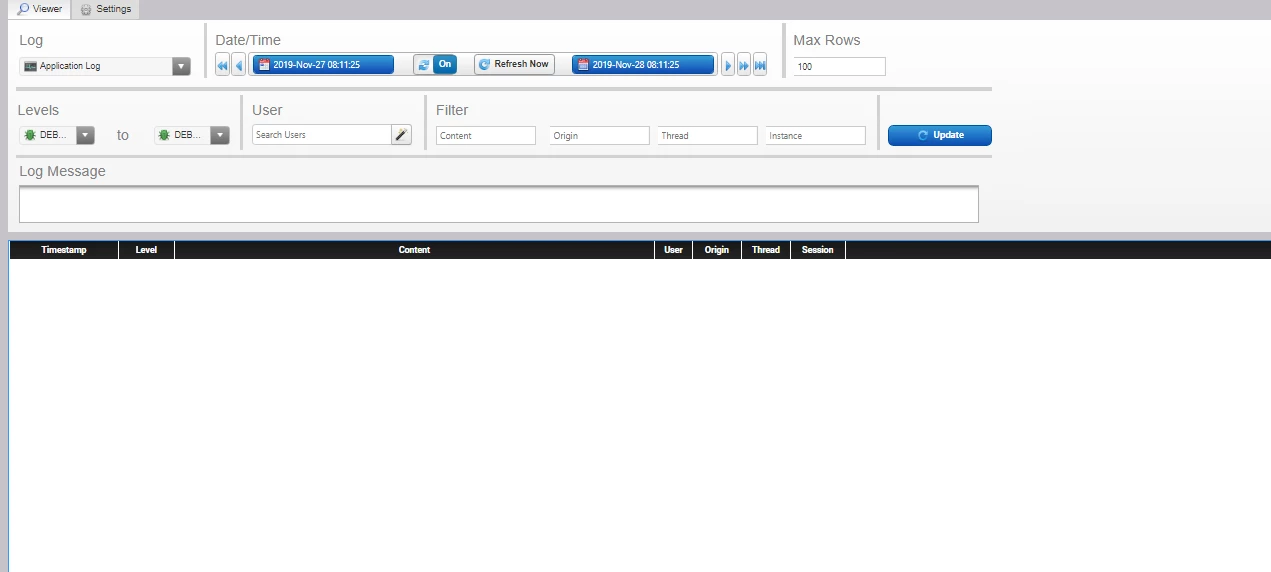

Hello All,
I am using Mail Server extension Version 3.6 to send mail with Attachment.
Issue: Not able to send mail with attachment have size above 470 KB and also not throwing any error while processing.
Please provide some idea to solve above problem?
Thingworx Version: 8.2.5
MailServer extension Version: 3.6

raluca_edu
November 28, 2019
Please help with more details:
1. which service you are using to send email?
2. emails without attachments are working?
3. are you trying to send image as attachment?
4. Set Application log level to DEBUG and send message again, upload Application.log here for analysis.
Thank you,
Raluca Edu
NERaj13-AquamarineAuthor
November 28, 2019
Hello Raluca Edu,
Thank you for quick reply Raluca Edu.
Please find my response in bold text.
service: SendMessageWithAttachment
Yes its working fine without attachment
No. I am trying to send the PDF file as attachment.
I have set the Application log level to DEBUG, but, didn't get any log (See the attached screenshot).
Nagaraj
raluca_edu
November 29, 2019
1. Please access Application.log directly on the server and attach it here.
2. Please attach a screenshot on the parameters of the service (to see path, name of file ...)
3. Mime type for the service for pdf should be "application/pdf"
