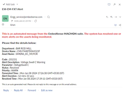

Actually I am able to send emails to the users from Thingworx Services, with the help of Email Extension
But Now a days ,People only Looking  into  Whatsapp, For Communicating to one another.
The Same Info, what ever i have sent in the Email, Need  to Communicate with the Whatsapp. Thats it.
