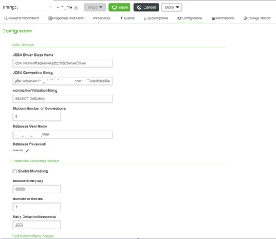

But normally if it is a MSSQL database you would use the "Database" base thing template when creating a thing.
This will give you a configuration page on that thing that looks like this:
In this configuration page you would provide the connection string (similar to what you would use when connecting to your database using for example SSMS (SQL server management studio).
You also need to provide an account to use.

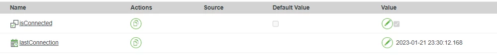

Once you save the configuration, you can go to the "properties and alerts" page of the thing and check if it has connected:
These are just the steps that we use to connect to our internal MSSQL databases. So you might need to try and find some other drivers if you are using a different database.
