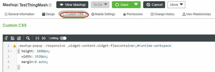

yhanAnswer
Jun 7, 2021 8:58 AM UTC
Then you can add the below css code to this mashup:
#runtime-workspace
{ height: 1080px;
 width: 1920px;
 margin:0 auto;

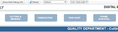

Jun 7, 2021 6:30 AM UTC
Thank you @yhan ,
 I have tried this, but no use.
This is how it will look like when it is FHD.
yhan17-PeridotAnswer
#runtime-workspace
{ height: 1080px;
 width: 1920px;
 margin:0 auto;
