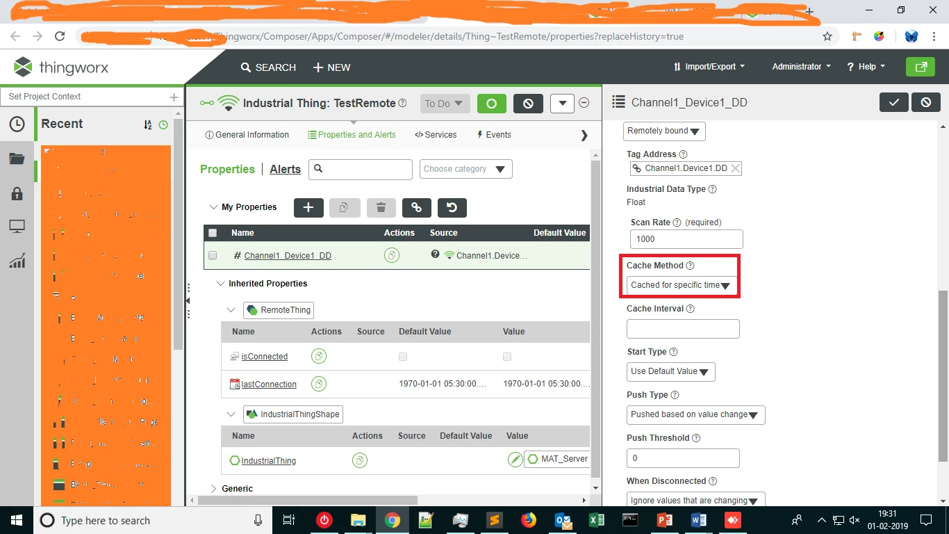

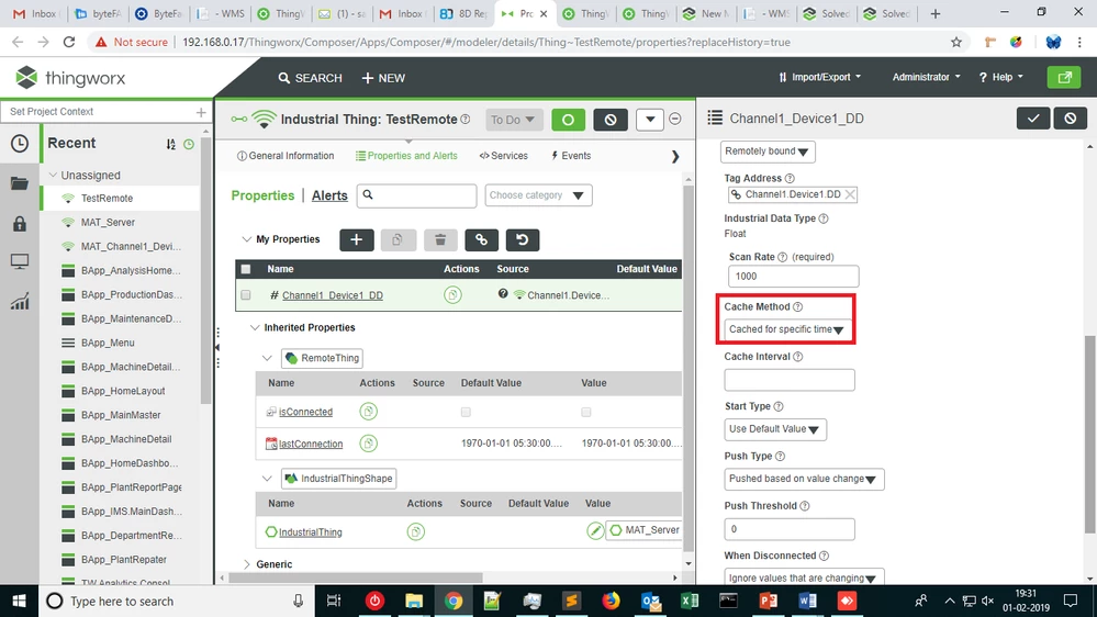

Hi All,
How can i create a property with remote binding and Remote Aspects.?
How can i change cache method programmatically?
Thanks & Regards,
Sathishkumar C.

Hello Sathishkumar,
If my understanding of what you are trying to do is correct I believe you can utilize the SetRemotePropertyBinding and set the cacheTime as desired. This should allow the Cache Interval to be set programmatically.
See the following article for further details:
https://www.ptc.com/en/support/article?n=CS298594
If I am misunderstanding what you are trying to do here please let me know.
