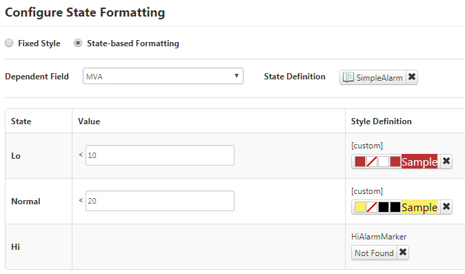

how to set the color to grid cell when its value is updated
Hi, I want to change the color of the grid cell when it is updated
aseatonAnswer
Jan 31, 2018 4:33 PM UTC
Sameera,
Use the RowFormat configuration to design how you want your grid to look based on values in the grid.
Here i have designed the style of the grid row based on the value of the property MVA. The grid will update as the property value changes.
as for a grid cell, i'm not sure we have the ability to do this yet. The new composer will allow us greater access using CSS and therefore i believe we might be able to achieve this kind of thing.
https://community.thingworx.com/groups/nextgen-composer/blog/2018/01/12/new-in-82-collection-and-css-editor
Hope it helps,
Andy
