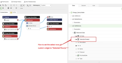

How to set the "Selected Row(s)" in custom widget ?
  • May 23, 2020
  • 4 replies
  • 2192 views
I created a custom table widget ,  the widget can bind data and display well .  When the table row get selected , I can get the selected row(s),  but  how can I set the  rows to  the binding service's "Selected Row(s)" ?
I can defined a JSON property as selected value,  but I prefer the standard mashup  binding style for selected rows.
Sean
Best answer by CarlesColl
I think something like:
// -- yourWidget it's the javascript instance of your widget
// -- Where 'Data' it's the name of the infotable property on your widget
// -- [array..] --> if you have single select, something like [3] or multi select [0,3,8]
yourWidget.updateSelection('Data',[array of indexes to be selected]);

seanccc17-PeridotAuthor
May 26, 2020
@CarlesColl ,
Thank you for your hint.  While I found updateSelection indeed used to update the Selected Rows,  the widget.runtime.js must also has function "handleSelectionUpdate" defined , otherwise the runtime framework will assume that the widget doesn't care about selection update.
one more question,  where do you get the following API comment ?   I couldn't find it in the ThingWorx Extension Development Guide .
Sean
May 26, 2020
It's my own one 😉
