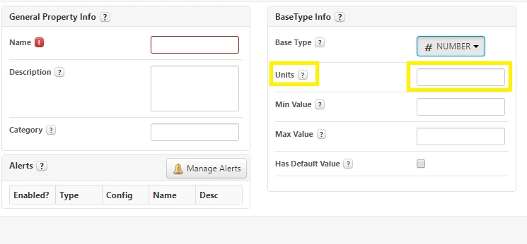

How to Set 'unit' value of a property through service ?
Hi Everyone,
I like to know how to set the Unit for a particular parameter through the service..
Thanks & Regards
Sugumar R
20-Turquoise
Apr 14, 2019 1:54 AM UTC
I don't think unit aspect can be assigned programmatically. Try the following, in your browser open dev tools (f12 in chrome), go to network tab. Update your property or create a new one with the unit value, then see the request load in your Dev tools. It should contain the aspects in json.
