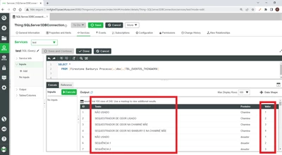

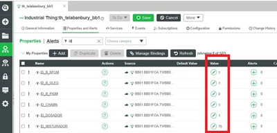

I have this project. Where we have a thing receving values coming from Kepware.
We have to replace this "values" to "text" and display to a mashup
For this reason we have a SQL query bringind all the data in a table.
Questions:
1 - Is possible, somehow bring the (thing values) as input parameters in the SQL query ?
2 - The (thing values) ​​have updates. For this reason, is it possible to do it dynamically?

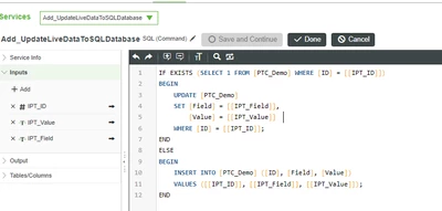

1) We can create Input parameters to SQL Command/Query by "[[VALUE FIELD]]" below image in Thingworx service,

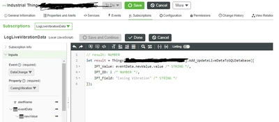

2) For automatic update of live value, you can call this service to your Remote Thing Subscribtions based on respective live property's Data Change event we can log the data to SQL Database
Note: This method may not be advised because it will hit the database frequently based on live data updates for each parameters due to that data traffic may occurs.
