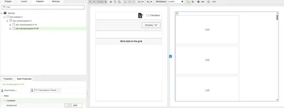

Hello everyone,
I am working on a ThingWorx Mashup where I have a flex container that contains a ptcs-dynamicpanel. This panel is divided into two sections:
  • Left Side: Contains more widgets and occupies a significant portion of the screen.
  • Right Side (ptcs-dynamicpanel-41 #2): Contains fewer widgets, but by default, it opens with too much width.
Issue:
I want to reduce the width of ptcs-dynamicpanel-41 #2 when the mashup opens. However, I do not see any width property available in the widget’s settings. I have tried adjusting the flex container settings, but the right panel still expands too much when the mashup loads in the browser.
What I Have Tried:
  1. Checking the Properties of ptcs-dynamicpanel-41 #2 – No direct width option found.
Expected Behavior:
  • When the mashup opens, the right panel should have a smaller width instead of taking up a large portion of the screen.
  • The layout should remain responsive without affecting the left panel’s visibility.
Does anyone have experience with controlling the width of ptcs-dynamicpanel? Is there a way to set a default width or restrict expansion? Any guidance or alternative approaches would be appreciated!
Thanks in advance for your help!
Jamal Ashraf
Mar 27, 2025 10:28 AM UTC
The PanelSize property on the widget ptcs-dynamicpanel-143 allows for configuration of the panel's dimensions. By default, the width can be adjusted using this property to suit the desired layout or design requirements. for example PanelSize= 50%
