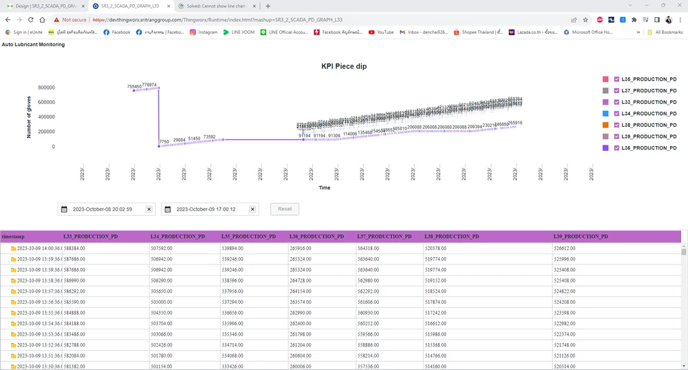

How to setting line graph
Now i got line chart like picture below but i want to modify something
1.X-Axis that is a time didn't show full date
2.On the right hand side, i want to edit sequence that L.33 is first one and then L.34 , L.35 respectively.
Thank you

Oct 9, 2023 7:43 AM UTC
Hi @DR_10558933
For Line Chart, you can try changing XAxisType to Date/Time and set XAxisDateFormatToken. Also, set HorizontalAxisLabelsRotation to 0.
In Widget Style Properties, reduce Xaxis Tick Label font size  to fit into the chart
For sequence, you can set NumberOfSeries to 7. Select DataField based on your sequence
/VR

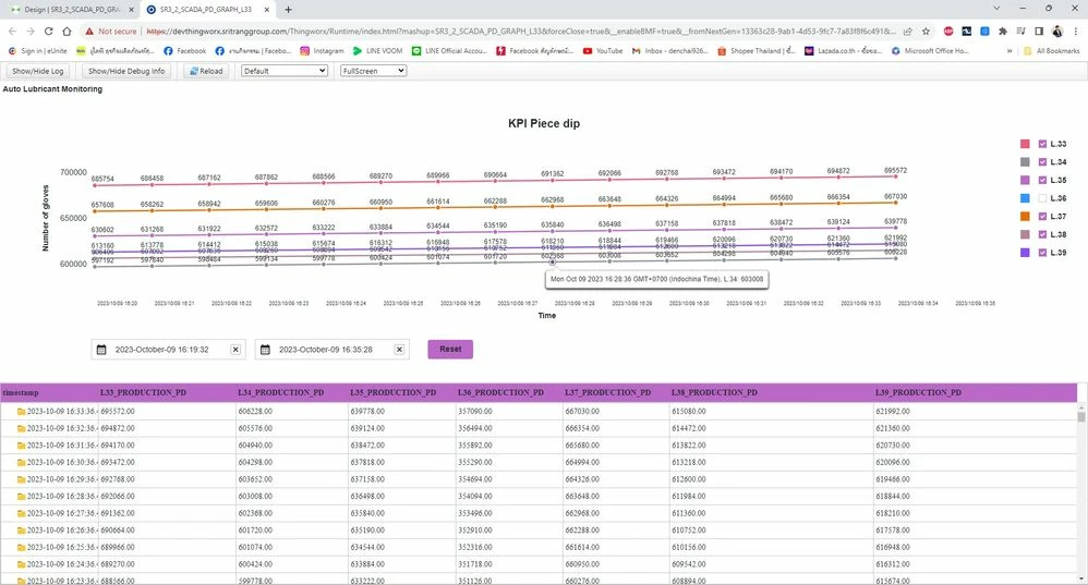

another question, can i change format when i put the mouse to some point at the line chart ?Untitled.jpg
Oct 9, 2023 10:45 AM UTC
HI @DR_10558933
For custom tooltip please refer here - Creating Custom Chart Tooltips (ptc.com)
