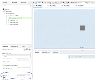

Nov 7, 2023 2:39 PM UTC
 Thank you so much for your instant reply it really helped
Just one more thing can we change Tab name like can we configure it according our choice I tried in the Property section like Display Name but changing if any other options that would be appreciated
Lav
Nov 8, 2023 4:53 AM UTC
Hi @LY_10691079
Yes, we can change the Tab Name. You should change Tab1Name widget property
