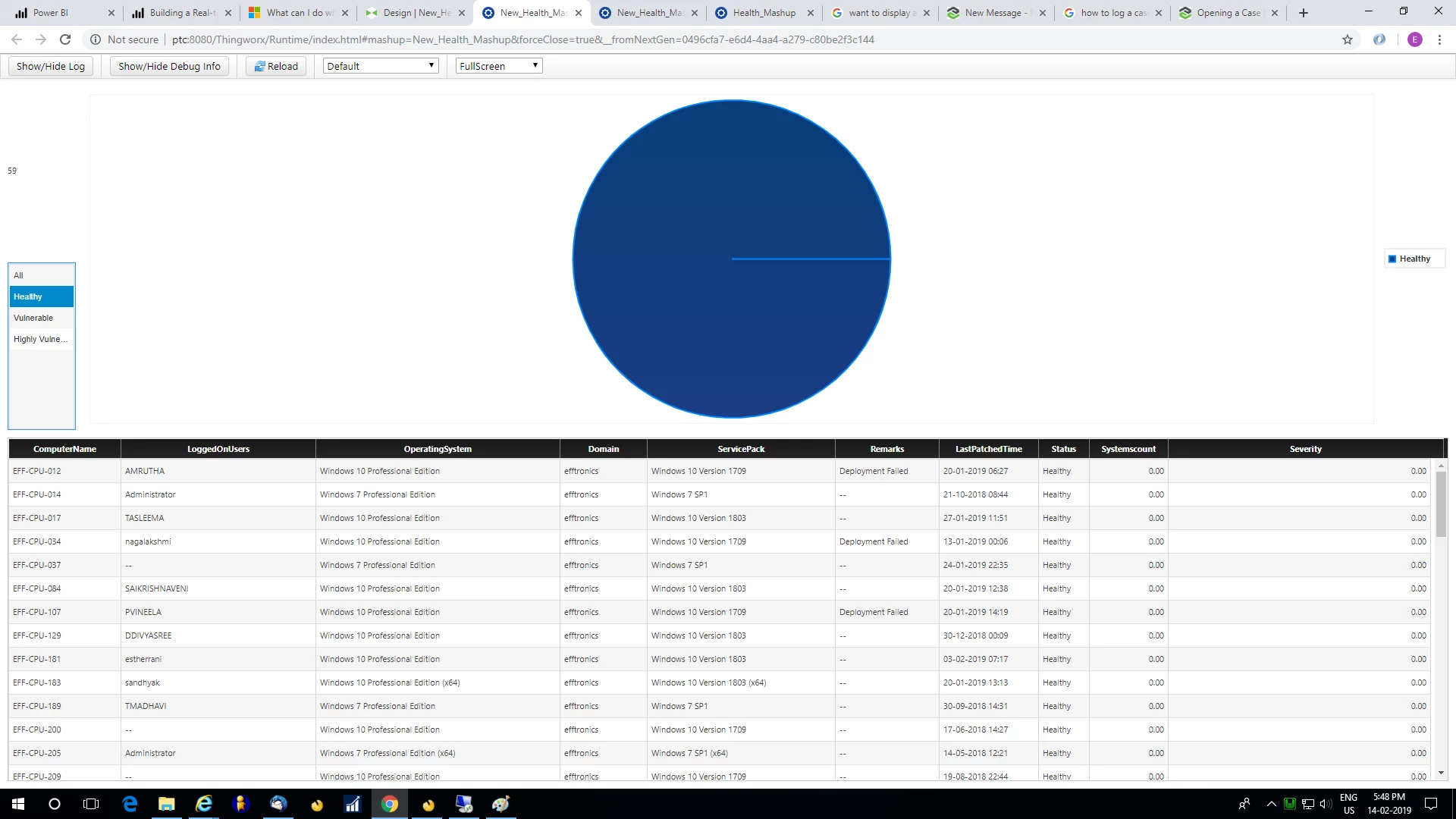

Can any one suggest on how to show the default data in widget when filter is not applied on List widget.
Here in my Mashup , Default it is showing no data in widgets . When it is selected on any item in list it is showing correctly. But I want to show all data default .

We have enabled the AutoSelectFirstRow . We have written the service manually regarding what items should be there in list. So we have given ALL option in the list in order to get the default mashup . But it is showing empty page when loading ALL as first option . we want to get the default mashup first and based on selection in list the widgets should change.
