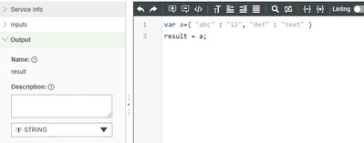

I have service through which I am getting output in Infotable format and there is a Json data in the output now I want to show that Json data in UI so for that I have used text area widget but I can't bind it so please help me here

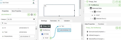

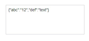

Feb 13, 2024 12:47 PM UTC
Hi @LY_10691079 ,
Please find the example as below.
1. Service output for JSON as STRING
2. Service binding in mashup
3. Output in UI
