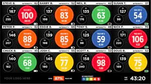

  • I have 10+sensor which having(member_id,heart_rate_device_id) parameter
  • I have created a service which is storing that live data into DB
  • I want to show all member live data on collection on time when it will come it should be a refresh of every member data
  • I have created an info table property which I am inserting live data but it should not update on member id wise it is adding the next row for the same member id
  • Please check the screenshot that I have attached I want to show the same as this.
Please suggest the way how to overcome this problem in thingworx
