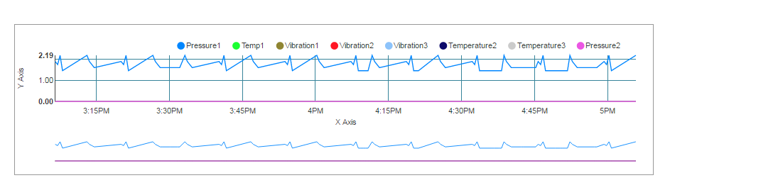

Dear Team,
How to show more than 8 series in time series chart.
As shown in diagram, 8 series are there . But I need to show 12 series then how can I achieve?

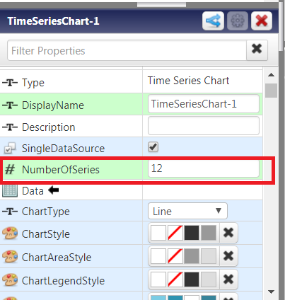

    Hi Bhuwaneshwar Gupta,
    You can show more than 8 series in a Default Time Series Chart by changing the NumberOfSeries value. But a custom extension one has a limit of 8..

    Hi Bhuwaneshwar,
    According to Custom Time Series Chart User Guide , the maximum number of series you can add is 8. You either have to add another time series chart for the rest of the properties or use the default time series chart.
