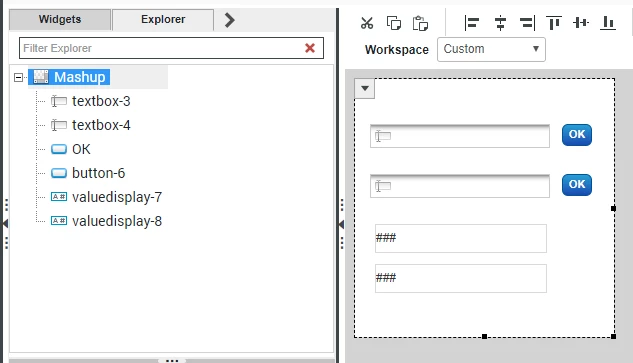

My mashup has two text box widgets, two button widgets and two value display widgets as shown in the attached image. Now I want to store the text box data in a table once the ok buttons are pressed and show the data in their corresponding value display widgets.
Though it is very basic and fundamental, step by step instructions would be much appreciated.

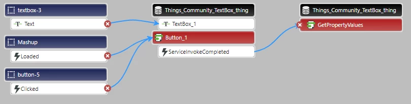

    • Text Box to the service which uses the value
    • Button to service to activate the service
    • ServiceInvokeCompleted to GetPropertyValues to update the ValueDisplays

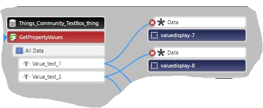

    • The fields returned from the GetPropertyValues are linked to the Value Display.
