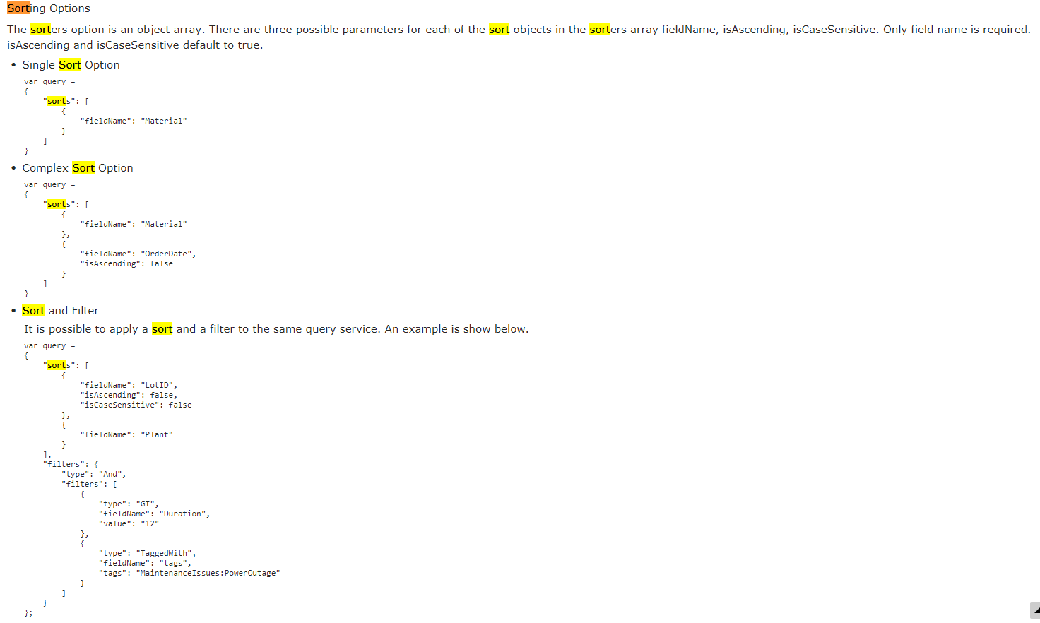

Hi Xiaoying, if the service you are using has the option to include Query parameter you can consider including the Sort option, this is covered in the Help documentation you can check here

Hi.
I think "sorts" parameter must be inside "filter" parameter, which contains also "filters" parameter...
So something like this:
filter: {
 "sorts": [
 "fieldName": "UID",
 "isAscending": false
	"filters": {
		"fieldName": "Name",
		"type": "EQ",
		"value": "myNameValue"
Sébastien
