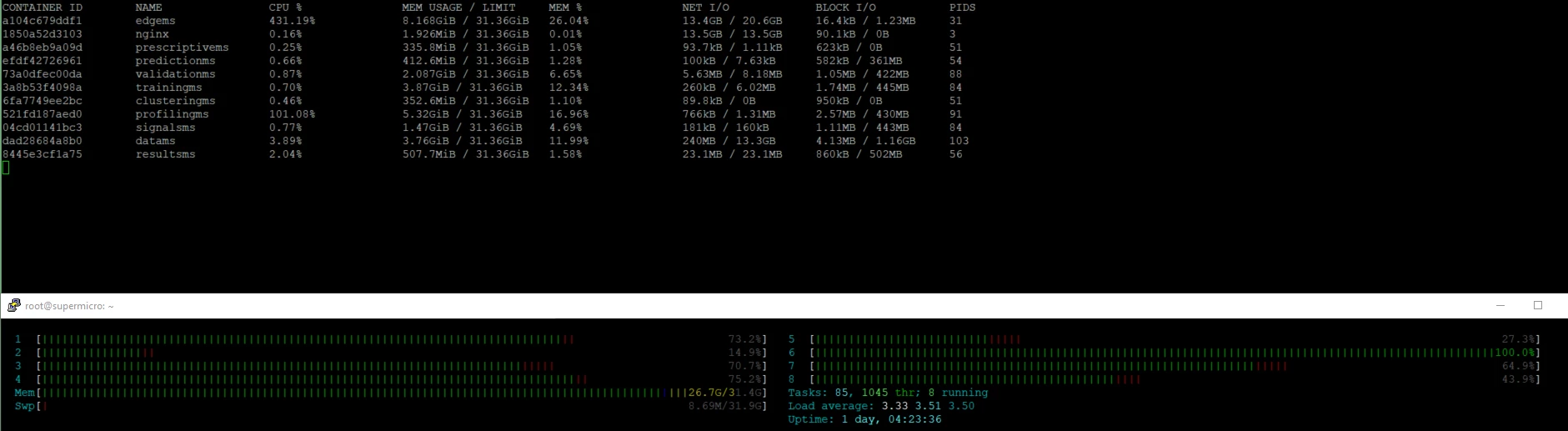

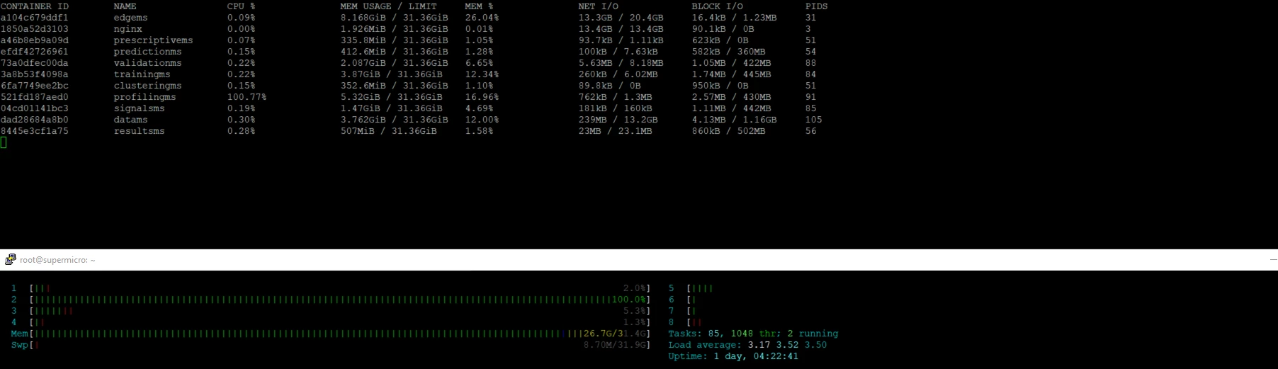

PS: In attachment I sent two images. The processors appear to be switching between a state of intense activity and a state of relative calm. It appears the edgems is oscillating between a CPU usage of around 0% (AnalyticsTroubleshootCalm) and of around 400% (AnalyticsTroubleshootNotCalm).
