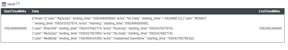

I attached a picture.
I would like to store json type data in one field, such as "infotable.png".
"startTimeMillis" and "EndTimeMillis" keep changing.
I hope you can help me.
vinakumarAnswer
Hi ,
You can add a field of baseType "json" in the datashape which you are using for creating Infotable to store the Json content in that field.
vinakumar12-AmethystAnswer
Hi ,
