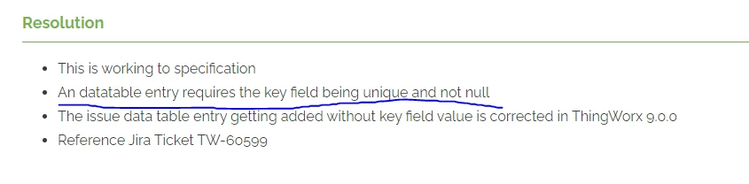

Hi @AP_10343008
Please refer to this article - Article - CS352005 - Getting Key field [xxx] had no value exception when adding data table entry without primary key value in ThingWorx Platform (ptc.com)
Based on this, if you are storing data in DataTable it is not possible to have null primary key value
