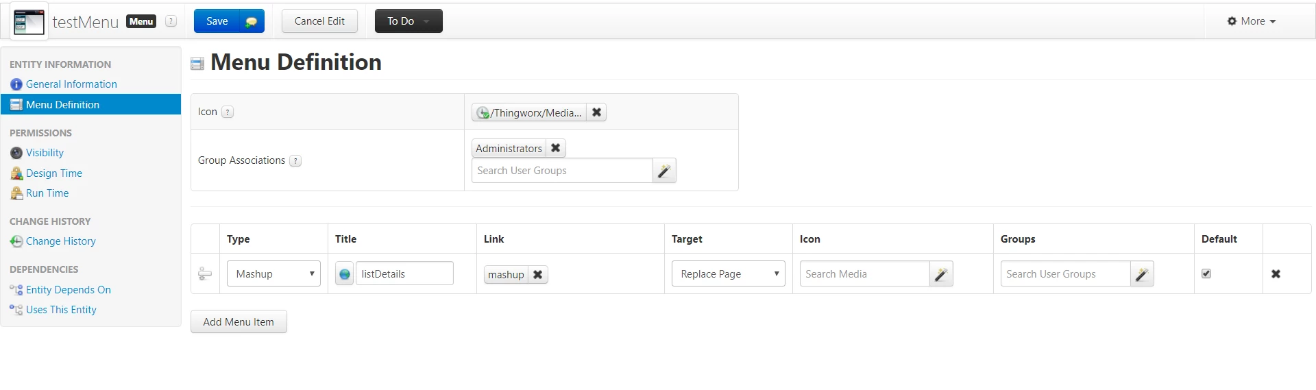

I am trying to create a Menu to open different mashups in a contained mashup widget.
Menu link has been assigned to different mashups and I have passed mashup name to "mashup widget".
But whenever I click a menu link it does not open anything. One observation that came across was a mashup name was not passed in the URL which was supposed to be added at the end. when added a mashup name at the end, that specific mashup was loaded in "contained mashup widget".
Please find attached files containing 1.menu definition
                                                          2. menu Name bound to contained mashup

Sorry I didn't look at the attachments, but looks like you are on the right path.
The Menu widget has an option to drive a parameter, once you enable that, the selected menu item value should be passed to your contained mashup name (if it is bound properly)

Thanks that resolved the issue.
