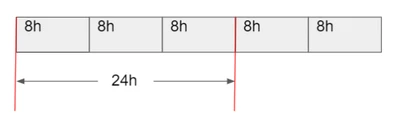

Hi @nsampat the post you linked is not what I'm looking for. Instead of the "wating/dead" time during training process I'm referring to this statement in particular "The 5 cycles must be within the 23 hours and 59 minutes, otherwise its considered a new training window." from this post
If each cycle longs say, 8 hours as in the image below, which would be the approach to properly train the anomaly detection module?
nsampat17-PeridotAnswer
Jun 28, 2021 7:30 PM UTC
@LR_9796586 ,
The recommendation I provided, and the post you linked, still applies here.
The only way to simulate the training cycle is to submit all the data in a shortened period rather than actively training on live data.
The 5 cycles are a recommendation to have an assured trained model, but if your system is on an 8 hour cycle, 3 may be good enough but I cannot guarantee that it will be optimal.
Neel
