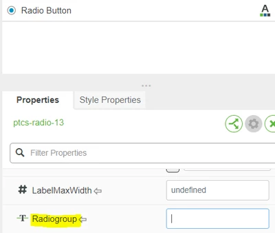

i have one mashup which have two radio buttons, so if i am selecting 1st radio button "Staff" and after that i am selecting 2nd radio button "Member" then 1st radio button is also still selected, i want to select only one radio button at a time. refer below attachment

    You will have to make both radio buttons part of the same RadioGroup by populating the property RadioGroup of the individual radio button.

    How i give radio group?
