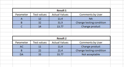

Please find below Sample information to get more detailed view on requirement,
I want above mentioned file as Template, Where Headings should be similar for every file and Area highlighted in blue should get values from thingworx infotable.
So in above case I need to have control to update cells of files ,not the complete sheet which only follows infotable structure to write file.
Please let me know if you need more information in it.

Hi @G_U ,
I believe you need to clarify for us some points in order to be able to effectively help you:
  1. You mentioned CSV or EXCEL. They are different formats, and then you speak about "area highlighted in blue" which is something a CSV file does not support. With a CSV you will not be able to obt
  2. From a programming perspective, what stops you reading the CSV, modifying only the cells you need to modify, then writing back your modified infotable as suggested by the members above? Looking from a different angle, why you need to have the capability to update on the disk if you can achieve the same thing faster by updating the full content in memory, then writing on disk?

@G_U
If you are open to creating an Extension, you can use the libraries provided from the Apache Software Foundation, Apache POI library. This library will give you the ability to create, read and modify Excel file types as well as CSV.
