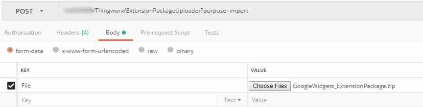

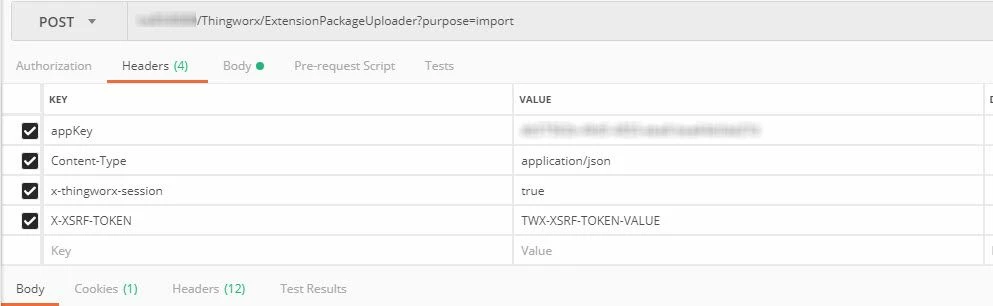

Hi @bwinslow24 could you try something like this :
curl -X POST \
 'http://hostname:port/Thingworx/ExtensionPackageUploader?purpose=import' \
 -H 'Cache-Control: no-cache' \
 -H 'Content-Type: application/json' \
 -H 'X-XSRF-TOKEN: TWX-XSRF-TOKEN-VALUE' \
 -H 'appKey: <appKey>' \
 -H 'x-thingworx-session: true' \
 -F 'File=@\Downloads\GoogleWidgets_ExtensionPackage.zip'
Edit :
Here's how it looked for me in Postman
