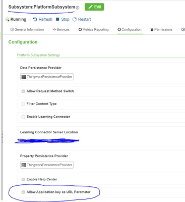

I have added the secret key when running Mashup why does the session box pop up to enter account and password still pops up企业微信截图_17096067192860.png企业微信截图_17096068736217.png

Have you enabled "Allow Application key as URL Parameter" in PlatformSubsystem

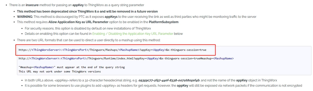

Also, I can see you used a different URL format
Please use the below format
https://<<HOSTNAME>>/Thingworx/Mashups/<<MashupName>>?appKey=<<APPKEY>>&x-thingworx-session=true

Yes, I have enabled "Allow Application key as URL Parameter" in PlatformSubsystem; and I've tried the format you recommended, but it still converts to the format I asked the question about at runtime.

Yes does redirect to index.html page. It is the actual or intended functionality of Thingworx
