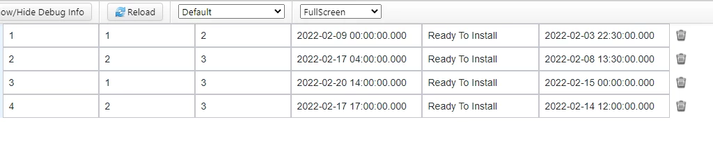

I have tried using a collection widget instead of using a grid , as I want to add a delete icon button which is when clicked a popup window should open.
I have added the delete icon button in my base mashup , which is repeated in the collection mashup , but on clicking it , the popup window is not displayed.
I have added the mashup parameters to connect the infotable data with the other columns.
How to configure delete icon button so as to open a popup window.

Sure , why not.
So firstly I created a base mashup in which I added 4-5 textfields so that it looks like a row of the table , then a button icon for delete
Then I binded the clicked event property of the button widget to the navigation function.
And then created a new mashup having the collection widget, in add mashup property of collection widget I added my base mashup.

Sure , why not.
