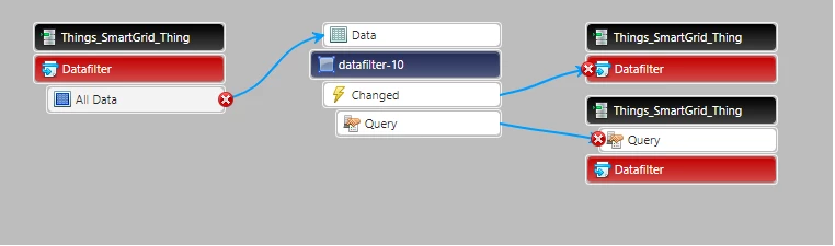

How to use Data filter in mashup? what is the service required?
First time am using this 'Data filter' widget.
I dont know how to use it
I saw video which is given in document.
There, they binding 'data filter-> query' to 'service' in thing.
Now my doubt is
what should i do in service? I must write SQL query? what query i have to use?
What should i give input ? How to get input query?
zyuan1Answer
December 24, 2018

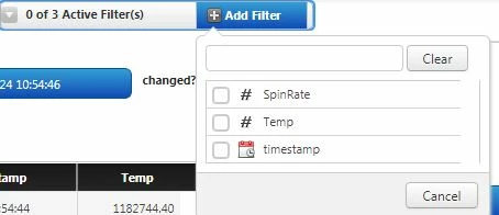

I don't know which version of TWX you're using, but it's quite clear to use it in TWX 8.3
You have a Filter widget, bind a infotable result from a service to it, and view mashup, you can then click on the Add Filter in the widget, and it will expand a list of propertis (from the infotable Datashape) to listen to.
Select any row, you'll know how to use the expressions. Then you can drag the Query field of the Filter widget to the service you get the Infotable data from in Data panel service list

January 2, 2019
I made all the connections.
Trigger service through an event
But data is not filtering yet.
In service i wrote "Select * from table" query..
Should i change anything in query??
