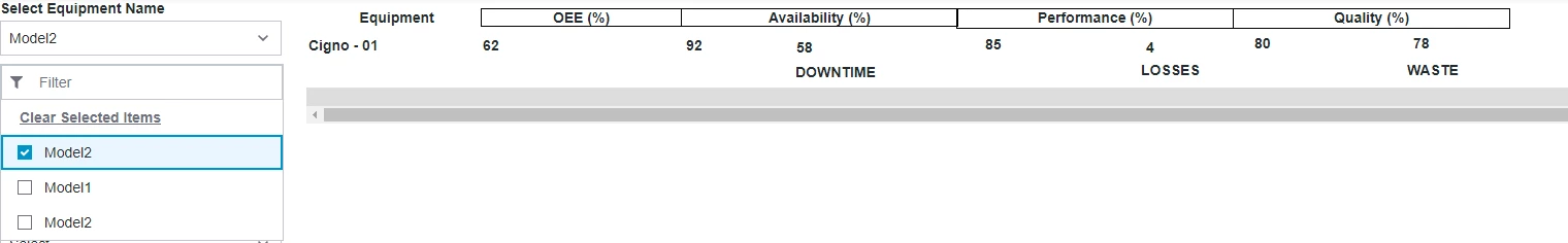

I have attached an image of my mashup

If you wrote the service then you would map that service into your mashup, bind it to your dropdown and indicate which field to display in your dropdown.
Remember that the service needs to be triggered by an event (like onload) to bring the actual data into your mashup from the server.
