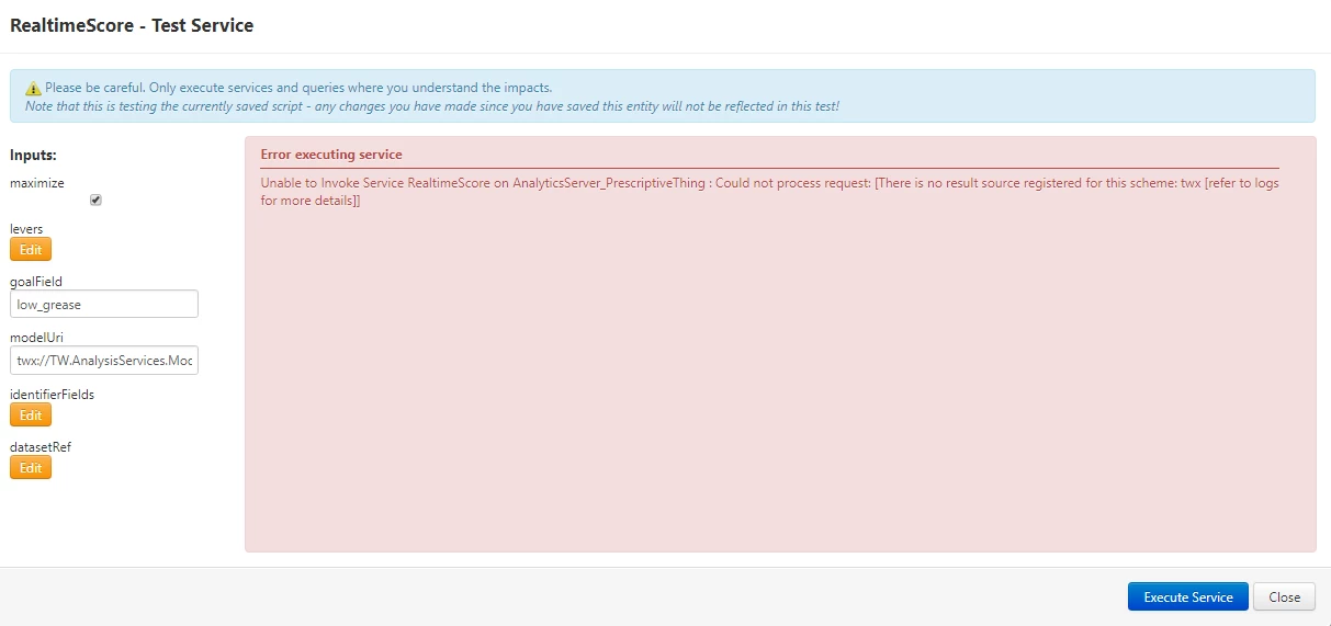

tqiu5-Regular MemberAuthor
June 4, 2018
Hi Morfin,
I knew this link, while I am still stuck in how to generate this long json content.
Now I am testing this  AnalyticsServer_PrescriptiveThing.RealtimeScore  by UI, and encounter error message as attached.
 I assigned modeluri as
twx://TW.AnalysisServices.ModelRepository/P1/ds_gear_Mdemo_fa43be14-1381-4268-9289-de65297d6763.xml
datasetref as
database uri  ---   dataset:/e51f8cdf-5c38-4442-bed5-f46439a3fc1a
format ---   csv
Can somebody guide me whether something wrong for these inputs?
Thanks.
Terry
cmorfin19-TanzaniteAnswer
June 4, 2018
Hi Terry
Just for the record, as we discussed offline
the format of modelUIr is of type http://<TWA server>/results/models/<jobId>
The format for dataset is parquet
Kind regards
Christophe
