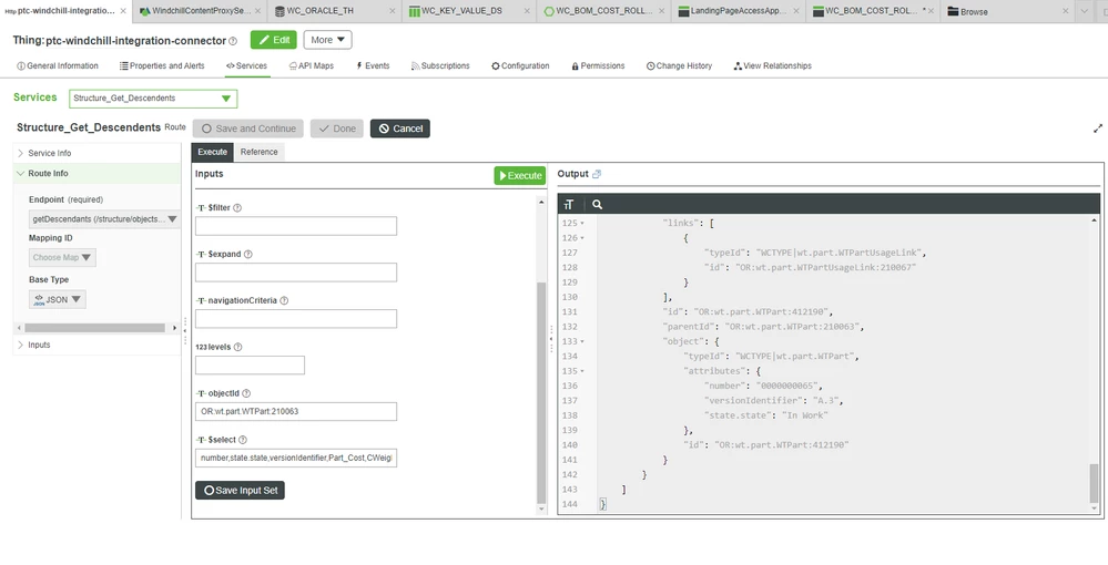

hello,
I installed windchill and thingworx foundation.

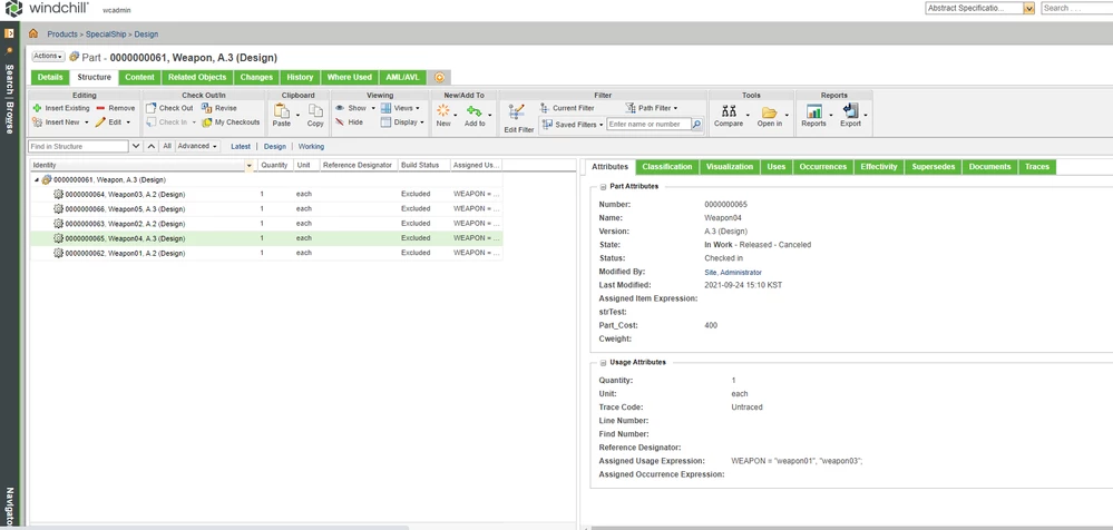

I added new custom attributes in windchill. (Part_Cost, Cweight)
and I want to bring these values in Thingworx.
So I excute Structure_Get_Descendents service use $select input in ptc-windchill-integration-connector
but the custom attributes values does not showing at output.
Did I miss something?
Look at the picture and check it out.
I'll be waiting for answer.
Best answer by MarekP.Nowaczyk
@YC_9410522 ThingWorx simply calls Windchill Rest service in this case Structure_Get_Descendents but usually has no control over what attributes are returned, that is defined in the service itself.
I suggest you have latest supported version of Windchill Rest Services installed and test the service directly in Windchill to make sure it returns the expected data.
