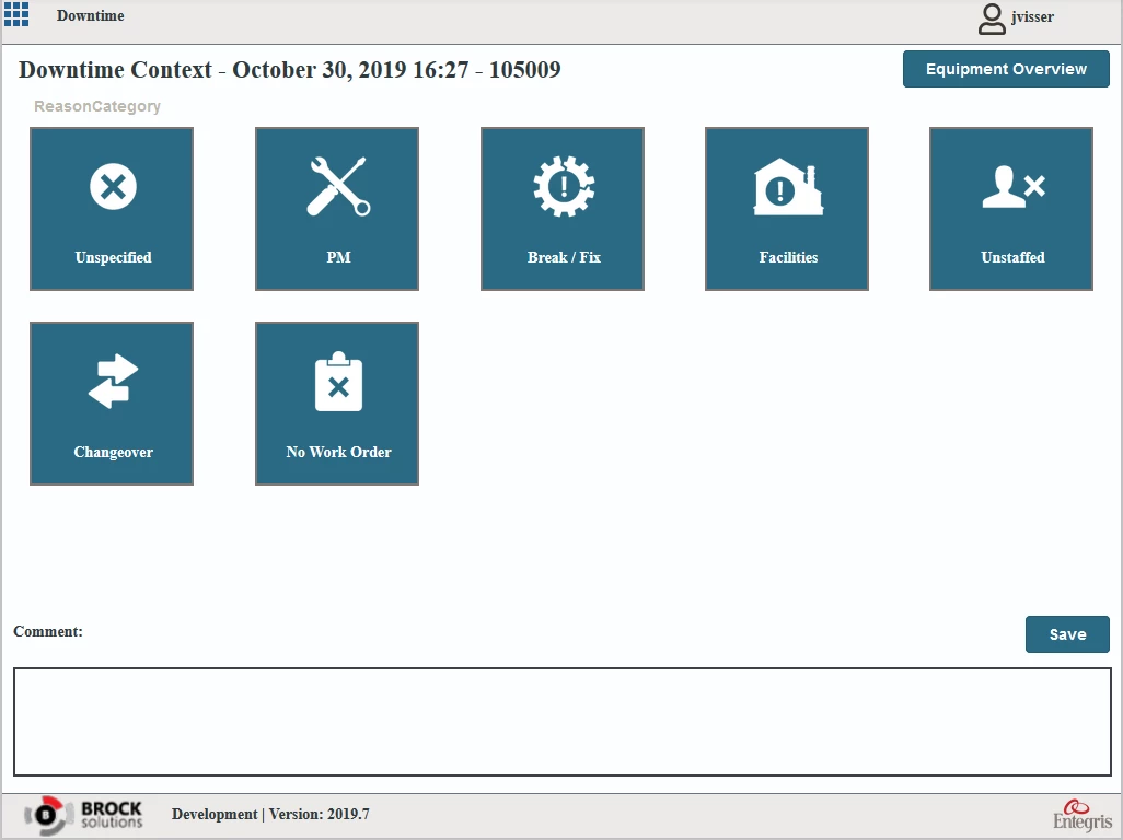

The use case I have is classifying downtime reasons. In this case there are some reason categories and each category will have a set of reasons. For the purpose of this example lets say the data is like a tree where any node could have multiple children and the depth of the tree is theoretically infinite.
See screen shot BreadCrumb1.png as the starting point.
Every time a selection is made(ex unspecified) the data set changes to the children of the node.

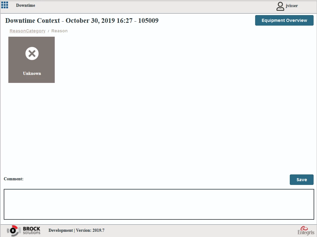

This can continue on and on until you reach your final selection and the path of selections should be shown in the breadcrumb at the top. If I want to go back I should be able to click on any node in the breadcrumb and that set of children will be shown.
