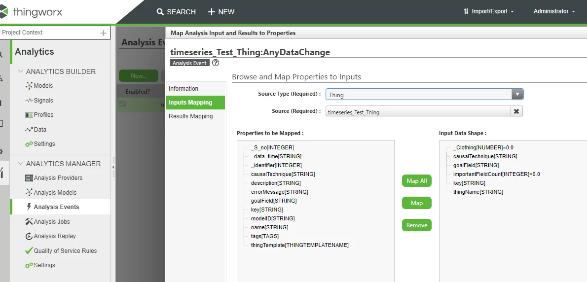

How to Use TimeSeries Model(created in analytic builder) with Thing to Predict next value in Series.
we have Time Series model created in Analytics Builder, Now I have to use it for prediction future values in series.
How can I use it in a Thing Object as service to predict future values and use it in Mashup UI for RealTime and Bulk (Batch of Time).
Stuck while doing trial-error-
1. I was trying to create a service in Thing Object.
2. I have created Data shape and Properties for this Thing.
3. Created Analysis Provider, Event, and model Publish.
Actually i was following this article and try to replicate for Time Series.
https://community.ptc.com/t5/IoT-Tech-Tips/Analytics-Prediction-Methods-Mashup/m-p/570921
Enclosed resource, errors, and Analysis Mapping(not able to see field for mapping).
Please suggest some thing service snippet for Time Series model Utilization.

Hi @MayankSharma20
I noticed that you already have a case opened with Technical Support on this topic.
This is the right thing to do.
My colleague, Mohit, from Technical Support will contact you on Monday on this.
Here is a summary from what I could see.
- you have published a model into Analytics Manager.
- In this case you do not need to create any service, the Analysis Event will take care of triggering the jobs
- you only need to have a Thing that receive input data
- you seem to be confused with the input datashape but it is as expected. Your model has been created with all the field excluded except the goal Clothing. So the only input is Clothing which happen to also be the goal.
This means that the Clothing field will be predicted from previous value of itself. If this is not what you expect, you should create the model differently. If this is what you expect, then simply map a property of the corresponding thing in the Analysis Event to the Clothing field.
- This article https://www.ptc.com/en/support/article/CS293493 should be of interest too.
Mohit will be able to give you more details if needed through the Technical Support case.

Thanks for your valuable response..!
As attached dataset, I can select any goal for prediction.
Rec_goods Clothing Footwear Chemist
Main thing
1. I am confused in datashape part and the way to read/consume model prediction using Thing.
2. Even i am not able to see fields while mapping data in Analysis Event.
I was looking the way to mapping, and the way(code snippet) to utilized the Time Series prediction model using Thing.
Mayank
