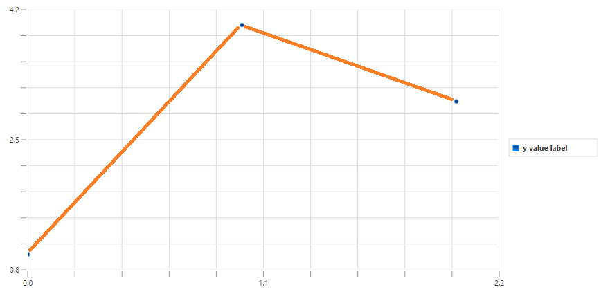

Tori Tielebein, I think he meant XY Chart, namely to be able to plot a line between two points (like in the pic below; orange lines were drawn in paint). The question is relevant to me as well. Thanks.

mnudel​ XY chart is a scatter plot chart, so the feature of connecting the points with a line is not available. Perhaps a time series chart would suit your requirements better. Please find information in  the helpcenter: http://support.ptc.com/help/thingworx_hc/thingworx_7_hc/#page/ThingWorx_Core_Help_Center%2FThingWorxHelpCenterDITAFiles%2FMashupBuilder%2FWidgets%2FWidgetTypes%2FXYChartWidget.html

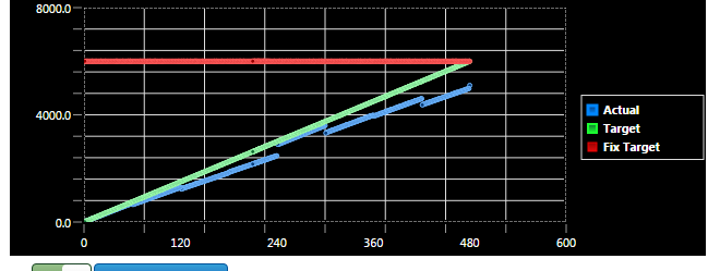

I had already tried this feature and i was able to join the points. For this you need to log your data in the stream and then using querypropertyhistory service you can plot that logged data on the xy-chart.xy-chart.PNG
