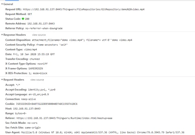

I use the HTML5 video estension and it works, however on the played video I cannot move the video cursor back or forward (to go directly to a specific position). When release the cursor into a position, it goes back to the previous playing position.
It just works moving back the cursor to the startup of the video.
I have this problem just with Chrome. Edge and Firefox works fine.
The mp4 file is ok, by testing it on a local html file with the <video> tag all is ok (even with chrome)
Is someone using this extension fine with Chrome ?
Jan 10, 2020 5:14 PM UTC
OK. So nothing wrong with the extension. What happens is that Chrome tries to request byte serving (sending the header Request: range 0-) and ThingWorx, since it does not support this, disregards this header and returns a response with code 200 in which it sends (in a chunked way) all the file. Chunked transfers and byte serving are totally different ways of serving content.
The problem is that Chrome is unforgiving and even if it does not receive the 206 Partial Content, it does not allow seeking. https://stackoverflow.com/questions/8088364/html5-video-will-not-loop
Preloading made no effect on this behaviour.
I presume that your other webserver returns a 206 or Accept-Range: none?
Check the response headers there and compare them to the TWX ones.
I consider this a bug in Chrome, especially since it has all the content loaded.

I tried now with
  • Chrome 79.0.3945.117
  • Thingworx 8.2.8-b856  (it is "cloud hosted" to PTC servers)
  • HTML5Video 1.0.0
but I have the problem
the mp4 video is located into a thingworx repository, and I use the repository path for the url.
This works fine on EDGE and Firefox.
May be it cloud be related on how the webserver "streams" the mp4 file ?
