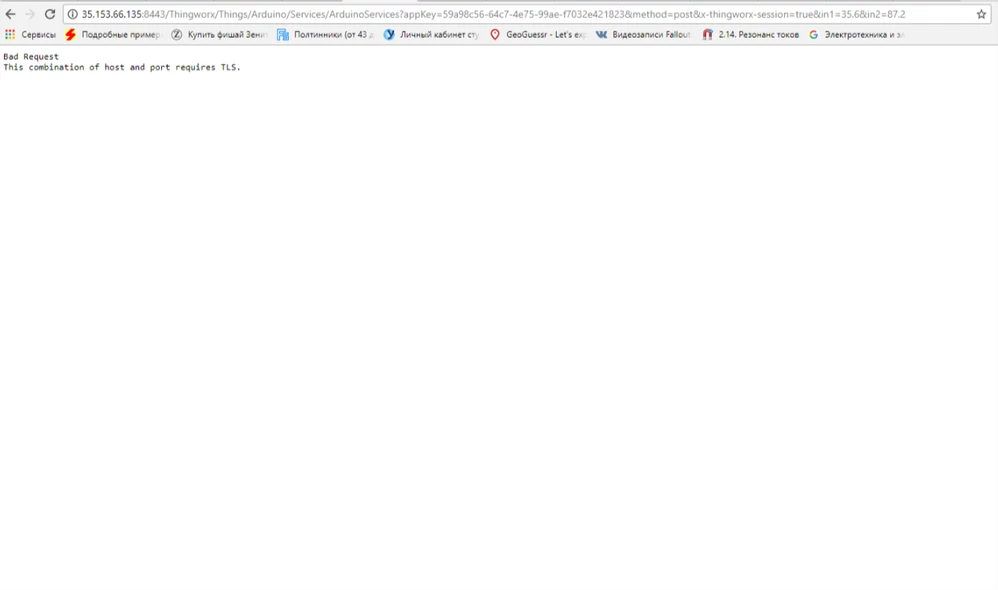

Набросок.pngHello! I have a problem with the HTTP request to the ThingWorx service. When I execute the HTTP request, I get the response (screenshot). Bad Request This combination of host and port requires TLS. But when I execute the HTTPS request, theservice starts and everything works fine. Help please! Sorry for my bad English.

This is happening because you are making a HTTP request with port 8443 .And i think your 8443 port is serving a HTTPS request .That is why it is stating that it requires TLS .Can you try HTTP request with a valid non TLS port defined in your server.xml ? Generally it's 8080 but you might have configured it to some other value also .

Can you locate this kind of statement in your server.xml ?
Define a non-SSL/TLS HTTP/1.1 Connector on port 80
<Connector port="80" protocol="org.apache.coyote.http11.Http11NioProtocol"
connectionTimeout="20000"
redirectPort="8443" />
Here the Connector port is for HTTP request ,like in the above case it is 80 .And any HTTP request will be handled from port 80.
