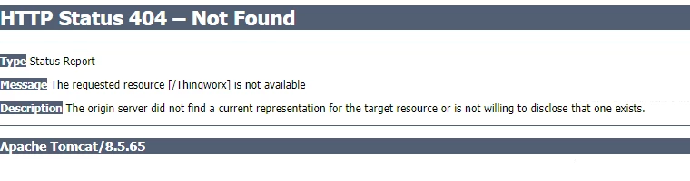

HTTP Status 404 – Not Found Thingworx not starting up
I have installed thingworx through thingworx.war file, but it not starting up, there are no errors in the error log or application log

When I Enter the IpAddress:80/Thingworx, I get following error

Support
September 24, 2021
Hi @pshashipreetham.
Check the <tomcat_home>\conf\server.xml file to verify the port ThingWorx is running on.  If you're not finding anything there, you need to check the Tomcat logs (<tomcat_home\logs) for more information.
Regards.
--Sharon
pshashipreetham
pshashipreetham19-TanzaniteAuthorAnswer
October 1, 2021
The issue is because of the of the Tomcat I have installed, The Thingworx version I have installed is 8.5, the tomcat version it needed is Apache Tomcat 8.5, I installed some Apache Tomcat version 8.65 or something, which didn't work. When Re-installed with 8.5 Apache Tomcat, it worked !!
