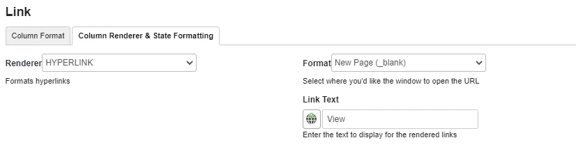

It may be due to grid settings, Please follow below steps
  1. Click on grid
  2. Click on Configure and Bindings
  3. Select Link column
  4. Click on Column Renderer & State Formatting tab
  5. Select Renderer : HYPERLINK
  6. Select Other parameters as shown in the image below

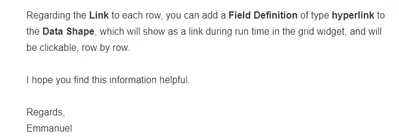

Hi @Ciprian-Traian
above post is more about Checkbox but they have provided below Answer for Hyperlink . see below screenshot of that post..and already i did the same but not clickable.

Ashritha15-MoonstoneAnswer
Jan 4, 2021 5:33 AM UTC
Hi @VS_9760165 ,
  1. Click on grid
