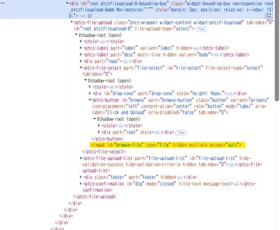

I'd like to edit default HTML when Mashup open.
I am a beginner programmer.
I'd like to edit default HTML automatically when Mashup open like from before to after below, because my device seems like don't accept "button" , but can accept "input" directly.
Is there an easy way to achieve this, or do I need to learn more advanced skills, such as creating a custom widget?
Thank you for reading.
before:
HTML Code
Visual on Mushup

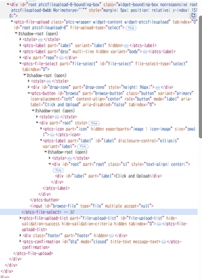

After:
HTML Code
Visual on Mushup

Aug 19, 2025 8:50 AM UTC
You can't influence/update HTML directly because it is generated by the widget, you would have to create a custom widget for this.
