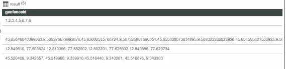

I had a infotable with values separate by "," , I should split that data and insert in to a location
I had a infotable with values separated by "," , I should split that data and insert in to a location basetype where using that location we should make a geofence on the map.
Please let me know how to split that data and insert into location base type.
find attached image for clarity.
Bhargav.

If you are looking to do a geofence you would need an infotable inside an infotable
outer table defines
RegionID RegionCoordinate RegionCoordinates
inner table RegionCoordinates has the set of coordinates
