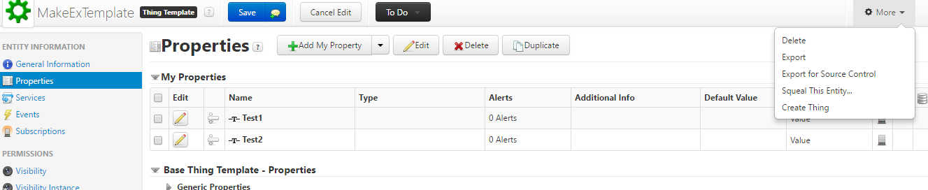

I have question about create thing using snippet
I create thing using snippet
n,T is Input parameter
so i create test1

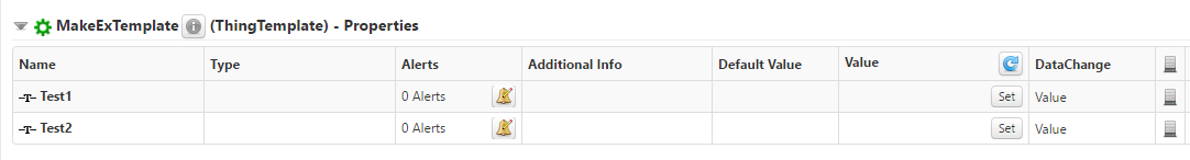

and i want set this property

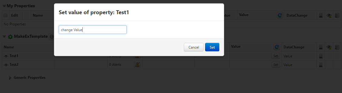

but Thing was created by snippet couldn't change properties
i input some test message in property Test1 Value
and click Set But
anything change...
but i create Thing using Create Thing in more button
it was changed properties
why i create thing with snippet can't change properties?

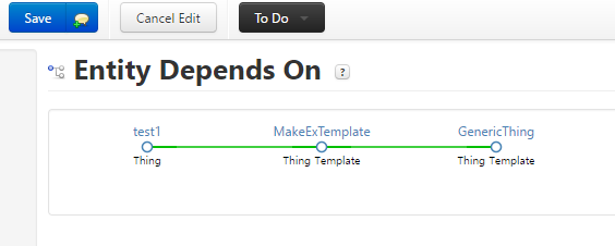

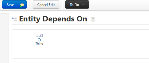

CHASEONHO18-OpalAuthor
18-Opal
May 17, 2017
Thanks Anna An
i try "Things[YOURTHINGNAME].EnableThing();" this script in my script
but doesn't changed...
this is make with create Thing in more button in Template
this thing was Depedns On display
and this is create thing with snippet
and any depends on don't display
is this issue make problem?
how can fix it?
