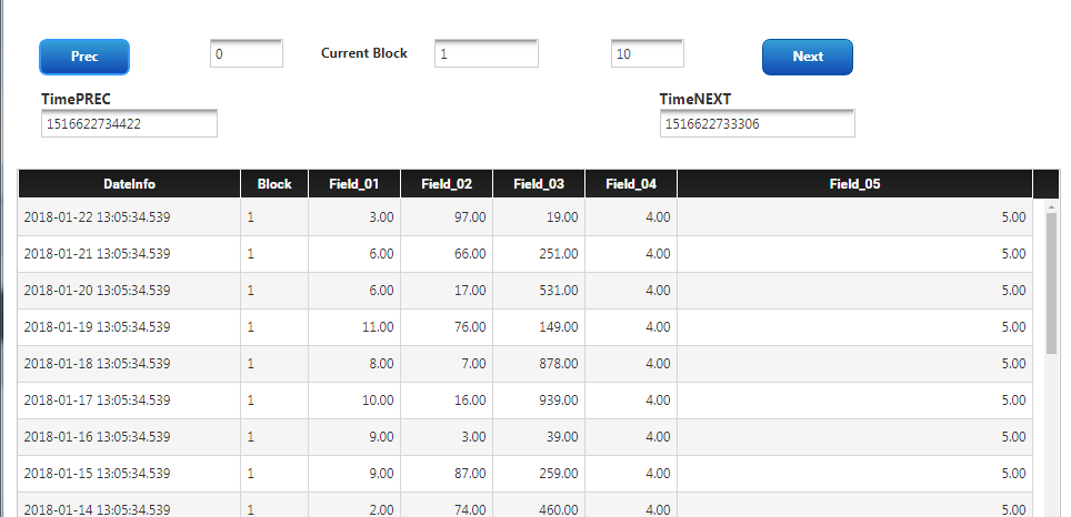

HI All, in the next figure one example about the question.
the Button PREC and NEXT must do increment or decrement the value of Current Block. The values od currente block are show into the grid.
The button PREC call SERVICE1 that set the value of current datatime from 01-01-1970 into text-box labeled TimePREC.
The button NEXT call SERVICE2 set the value of current datatime from 01-01-1970 into text-box labeled TimeNEXT.
Using the event ServiceInvocheComplite , at the end of service SERVICE1 or SERVICE2 another service its called.
This service using the value on text-box labeled TimePREC and TimeNEXT to  identify the last button pressed. In this way the service increment or decrement the value od Current Block and get the data value of current block.
Last operation is to  set unvisibile the label and text-box about TimePREC and TimeNEXT
Please let me know if other information, or assistance is needed.
BR
Dimitri
Jan 22, 2018 12:29 PM UTC
Hi Dimitri,
You can do it for sure with EventsRouter widget. (It is available since 7.4.0 version of ThingWorx).
All you need to do is bind result of Service A to input1 param of this widget and result of Service B to input2 param.
In the output parameter of EventRouter widget you will receive value of the latest invoked service.
Let me know if that was what you were looking for.
