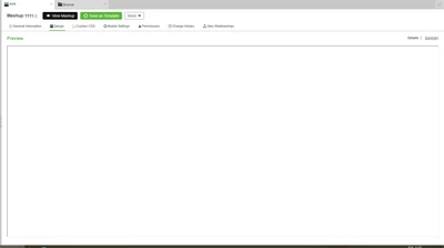

I've given it permission and it still won't run.
I've created an account, I've granted it permissions, but it still won't run.Why? Please help.

Hi @Snoopy_hu ,
Pls follow the article for the non-admin users: https://www.ptc.com/en/support/article/CS227181
Kindly revert back if issue is still present.

Hi @Snoopy_hu ,
Are you trying to create a new user account and it is failing?

Hello @bchaudhary_448008
I'm trying to run the mashup program with a non-administrator account, but the run screen is blank!

Hi @Snoopy_hu ,

You didn't explain what you want to do, so I assume it is editing a mashup?
You would have to give design time privileges.
Probably also access to some other objects/collections, might be easiest to put your user into Developers group.

HI @Rocko
Yes, I'm trying to run a mashup, but the run is failing
