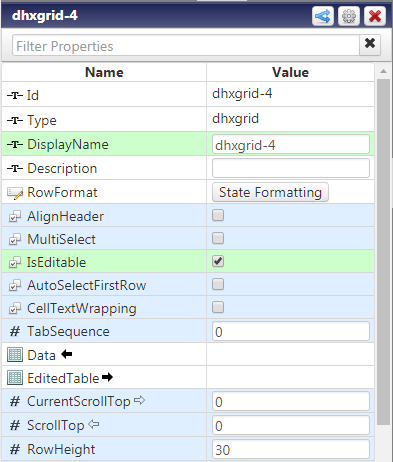

I want to create a Checkbox to select a row in a grid..? Is it possible..?
with the help of it I want execute some actions such as edit and delete..?

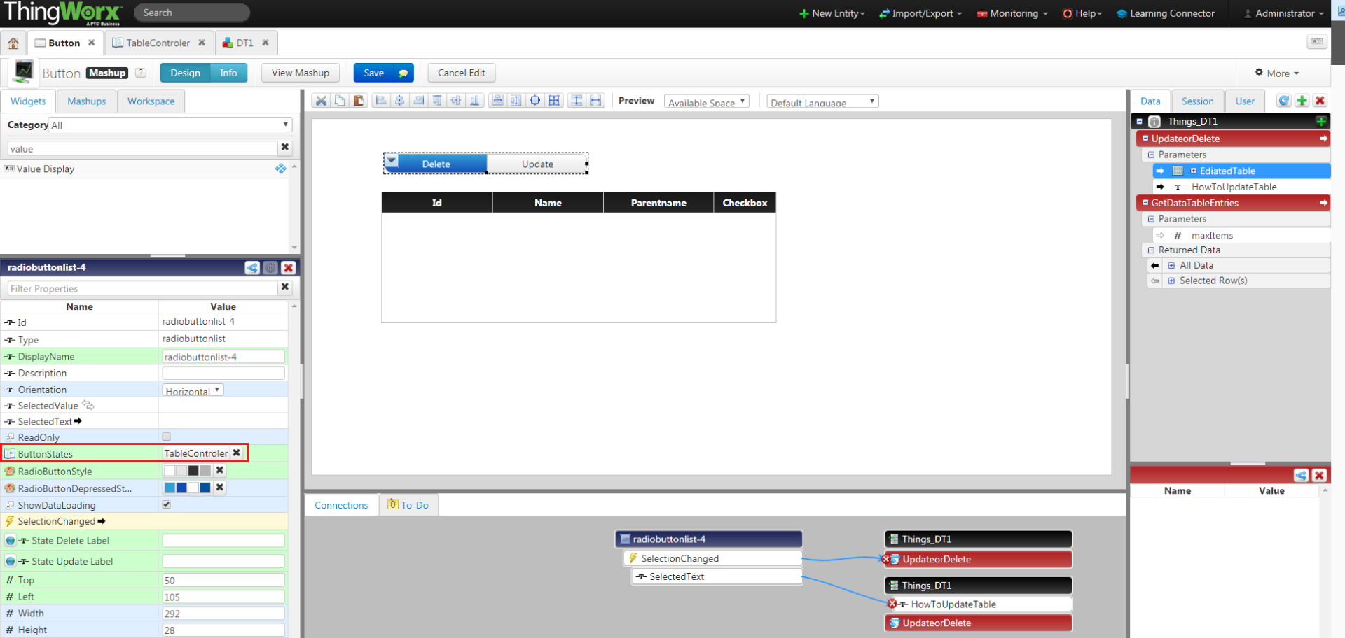

What your screenshot displayed is our composer page, not mashup or widgets, which means we cannot have an exactly the same design on your mashup. I designed a sample that may work for you.

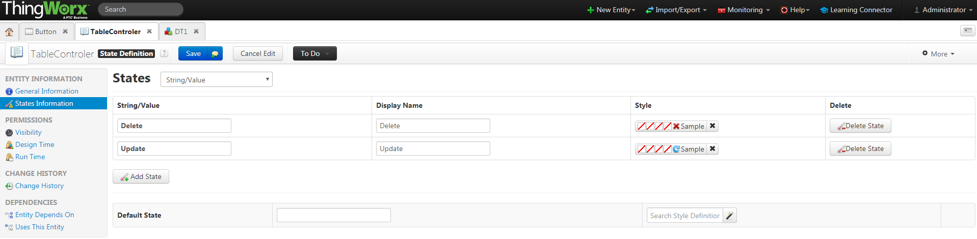

1. Create a State Definition named TableControler
2. Create a Mashup and add Radio button  and Grid widgets on the mashup
     The Grid should be set up as my first replay.
     The Radio button should bind TableControler for it's ButtonStates

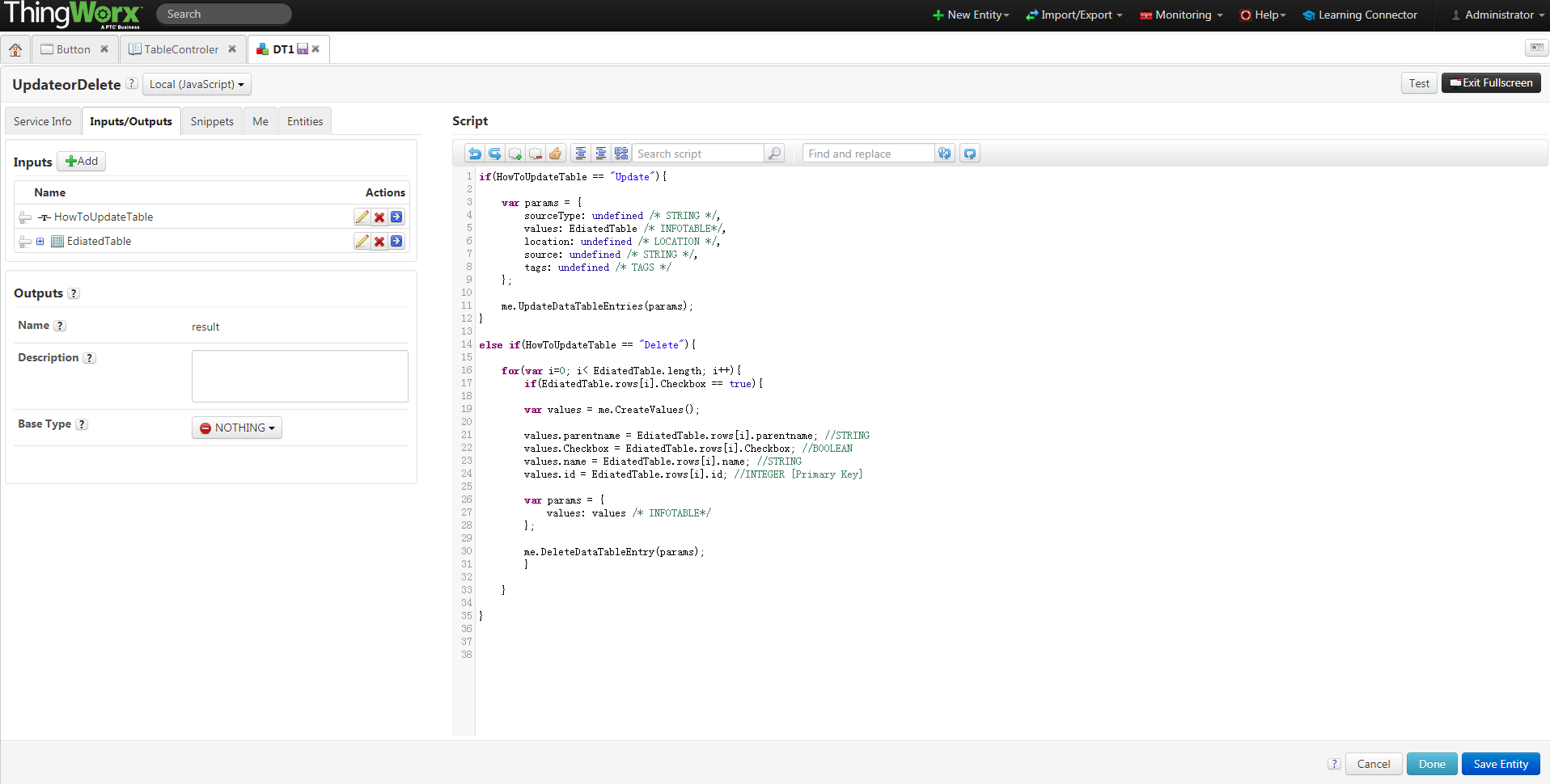

3. Customized service to response delete and update event is very important. My customized service named UpdateorDelete
4. Bind Radio Button's Selected Text to UpdateorDelete's input parameter
     Bind Radio Button's SelectionChanged event to UpdateorDelete service
     Bind Grid's EditedTable to UpdateorDelete service
     Bind UpdateorDelete's ServiceInvokeCompleted event to GetDataTableEntries.

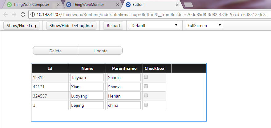

The run time page is like this.

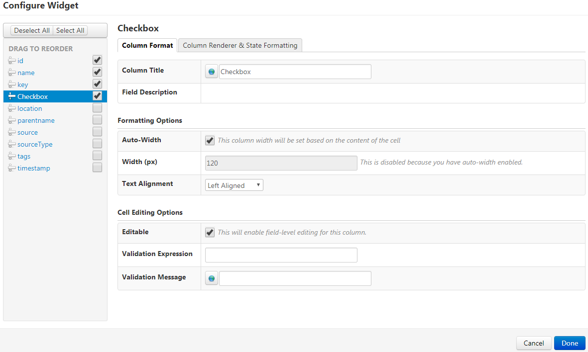

Hi Nalla,
Yes, it' is possible.
You may need to add a boolean colum for your table first and check this colum is editable.
My sample: Checkbox is boolean type. And the default is false. (I set Checkbox default value to be false)
Also please check the IsEditahble for the grid
Bind the editedTable to the service that can upate the datatable. (Your customized service).
Should you have any concern, please just let ne know.

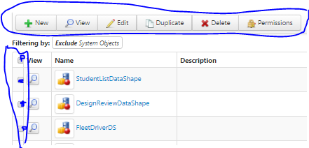

My requirement is as shown in figure. I want to create such buttons and boxes.doubt.PNG
