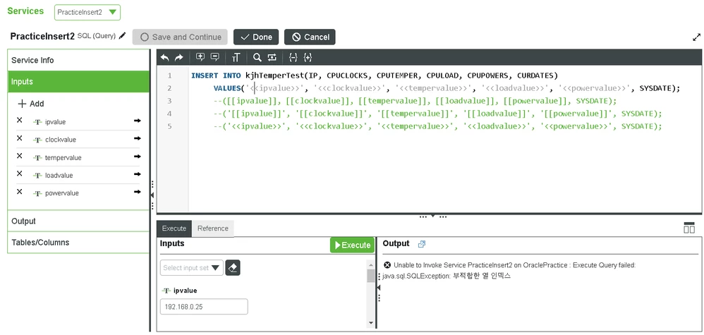

I want to save data in oracle
  • September 4, 2019
  • 2 replies
  • 1434 views
I saw this manual.
https://developer.thingworx.com/en/resources/guides/external-databases/external-database-write
but Invalid column index Error confirmed.
I used two methods.
SQL (Command), SQL (Query)
And I used three methods.
([[ipvalue]], [[clocksvalue]], [[tempervalue]], [[loadvalue]], [[powervalue]], SYSDATE);
('[[ipvalue]]', '[[clocksvalue]]', '[[tempervalue]]', '[[loadvalue]]', '[[powervalue]]', SYSDATE);
('<<ipvalue>>', '<<clocksvalue>>', '<<tempervalue>>', '<<loadvalue>>', '<<powervalue>>', SYSDATE);
The inputs data are all strings.
Configuration is not wrong.
I think my method is wrong.
Can you help me?

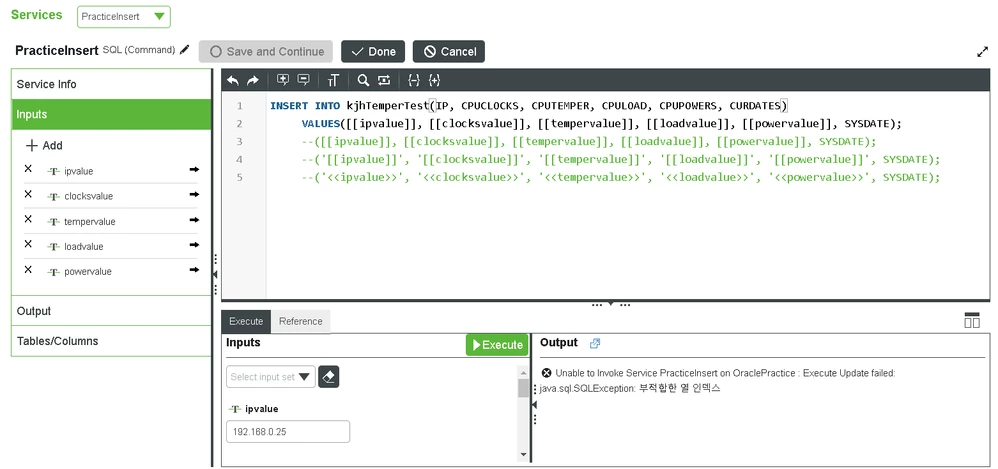

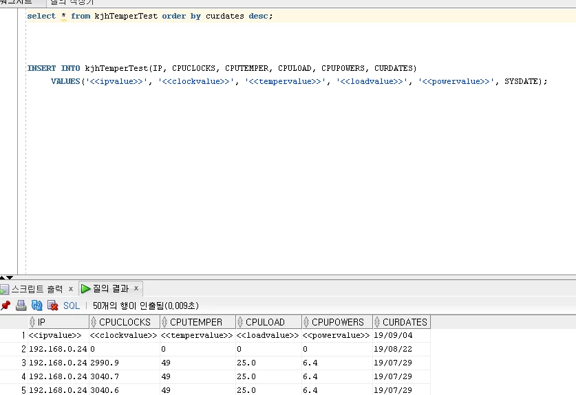

Best answer by KANGJAEHYUCK
hi.
Thank you for your reply.
The problem has been solved.
I put it in SQL(Command).
and
I've used the following methods:
INSERT INTO kjhTemperTest(IP, CPUCLOCKS, CPUTEMPER, CPULOAD, CPUPOWERS, CURDATES)
VALUES([[ipvalue]], [[clocksvalue]], [[tempervalue]], [[loadvalue]], [[powervalue]], SYSDATE)
And then I removed the annotation.
The annotation was bad.

Second service is correct, PracticeInsert, always an insert should be put in a SQL(Command).
Have you provided values for all the parameters? Try without "<< >>".
In the Application.log of Thingworx what error do you see? Can you please translate in English the SQL Exception?
Thank you,
Raluca Edu
