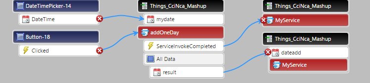

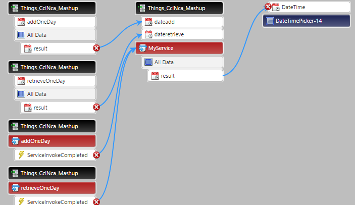

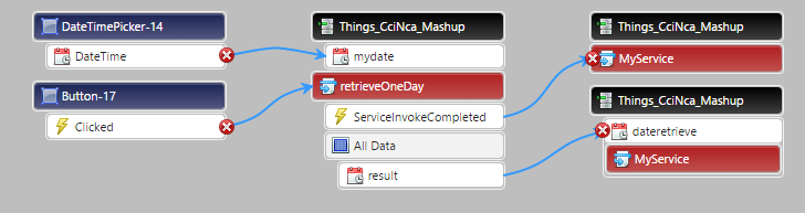

Quang-Dung
October 11, 2016
Thanks for the work around. i used it for two buttons, one adding one day and the other retrieving one day, and the result of the two services associated with the buttons goes to a datetime picker trouhg a custom service called MyService wich is based on the source property of the thing,
