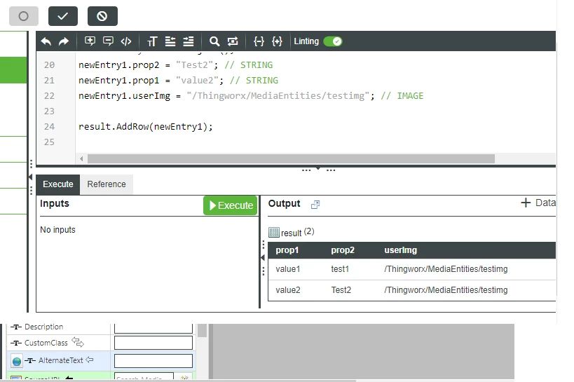

I am able to do it use following steps:
1. infotable should return the image url in string form like this "/Thingworx/MediaEntities/testimg" see infotable image as attached

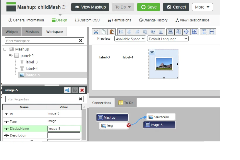

2. create a child mashup which you want to repeat on collection. Create 3 mashup parameters( I am supposing 2 labels and one image on collection) of String datatype and bind it to your value. Bind img string type with the image url of Image. find in attached images as childmash.
3. Once in the collection, when you select the child mashup, you will find MashupPropertyBinding property and provide value as Json (  {"prop1":"lbl1", "prop2":"lbl2", "userImg":"img"}  ).  Here lbl1, lbl2 and img are child mashup properties and prop1, prop2 and userImg are infotable columns.
