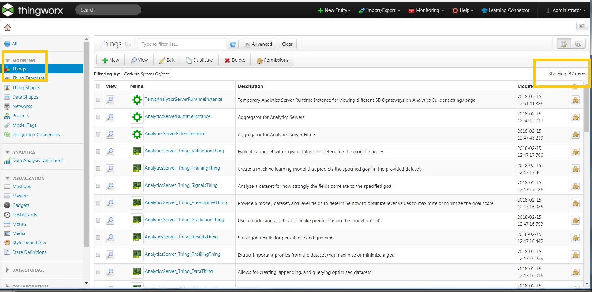

Hi ,
        I am using thing worx developer trail version. I am trying to upload the lab files downloaded from the developer thing worx .com. The "ThingworxFundamentalpreloaddata.json" entities files are not getting imported . i am getting error as "Internal error: java.lang.Exception: Import Failed: Allowable limit for licensed feature User is reached "
Kindly guide me to overcome this issue.

About the " The LAB files exceed the limitations for users (8) set on our trials" , ThingWorx Trials has user creation limit of 8 while LAB files from the training classes will try creating more than 8 users.
So the error happened because during importing more than 8 users be created and that overreached the limit.
You can check user limit of your TWX instance as below.
1. Open following page.
     Monitoring -> Subsystems -> Licensing Subsystem Settings
2. Check "AvailableFeatureCount" of row  with "FeatureName : twx_named_user"
     TotalFeatureCount means user limit, AvailableFeatureCount mean how many available are left.

The trial editions are capped at 150 Things.  It looks like you have reached that limit.  How many things do you currently have?  You can identify in Composer.

At this time, the ThingWorx Trials from the Developer Portal will not be able to import the LAB files from the training classes.  The LAB files exceed the limitations for users (8) set on our trials.
