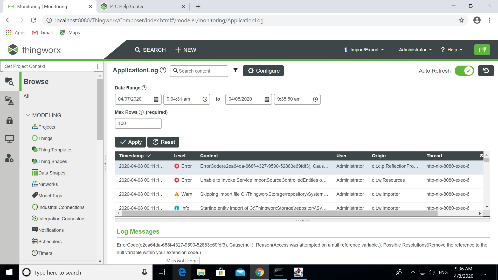

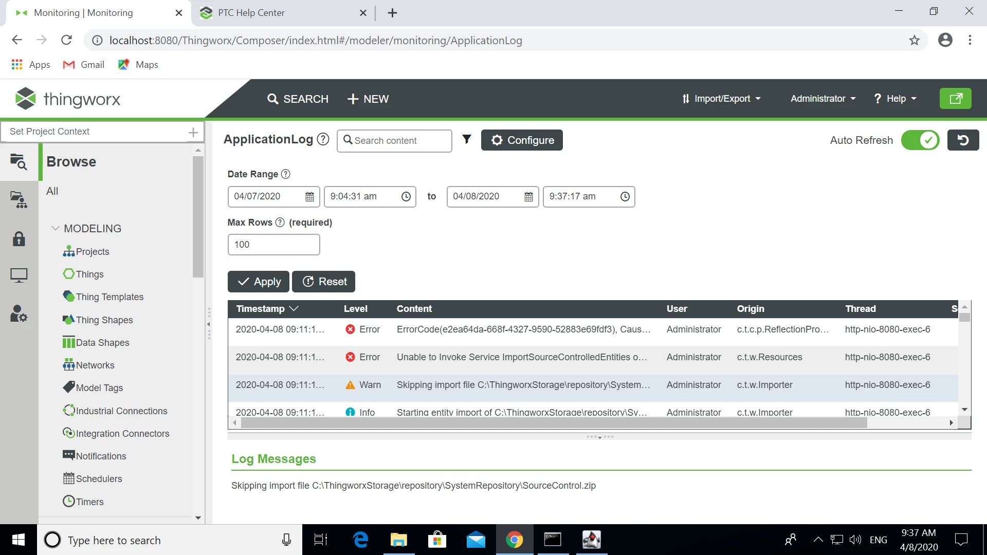

I am trying to replicate the same project from local to cloud.
Exported the source control entities to "System Repositories" and copied the same zip file to cloud i.e. "Virtual machine" system repository.
Throwing "Import Failed" error.

Try unzipping the file into a set of folders in the repository and try import again?
I am not sure if you are pointing directly at the zip, but I thought it couldn't import from a zip.

Hi PaiChung
Thank you for your response.It has worked after media entities imported to cloud separately.
